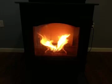

Running P68 on stove temp mode setting 5 and feed rate 4. Blower dial is in the middle. Does this flame look normal? It splits and leans forward a bit.

Your burn pot may need a good scraping or one or two of the holes in the pot are plugged not allowing air into that part of the fire burn
X2. Scrape burn pot and give it couple of taps with the scraper and knock those holes free of ash.
Also clean around the igniter. This is the path of the combustion air. If it is blocked it could cause a lazy flame.

I keep the stove pretty clean. I turned up the temperature and the flame looked better.
