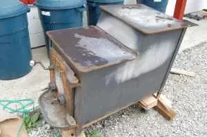

    Below are pictures of a hard fired Papa that shows where the whitened paint took the most heat. Even this extreme heat only destroyed the paint, and doesn't appear to bulge or warp the stove. It doesn't appear damaged. So it takes a LOT to abuse one of these.
