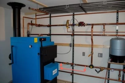

I would like to add an additional pump to my system to increase flow when I get near the end of storage charging. I would control it with an aqua-stat that would activate the pump at a desired supply temp to increase the gpm.
I am thinking about placing a T in the supply line near the boiler and back in before the storage tank.
I need some advice on where to place the T and if there are any drawbacks or concerns.
Some of my concerns are location of new pipe in relation to;
1. Air separator
2. Bypass for Danfoss
I have included a picture with my initial choice.

If you put the second pump in a by pass loop you will need a one way check valve or the flow to storage will take the path of least resistance when just the first pump is working and will just go around in circles at the by pass loop .
Very nice installation!
Probably first need to plot your piping resistance curve against candidate pump curves to make sure that you need parallel pumps and not series. Probably parallel would give more flow, but it's hard to sure without running the numbers.
And as hh says, need check valves. If the new pump had IFC that would take care of it, but if the first pump fails it would be nice if it had IFC as well for automatic failure mode operation.
The Danfoss has a nice Cv of about 20, IIRC, so not much to be gained by bypassing it. I suppose you could add an EBV to the hot leg of the Danfoss for a positive shut off, but seems hard to justify. As for the air separator is seems like bypassing it from time to time would be harmless, or just move it upstream of the tee-in point if you're worried about it.

I had a similar problem. The boiler would start cycling when storage would hit 170 so I went to a pump with about 30% more capacity.
On using a second pump - installing it in a by pass loop at the storage tank on the return side may give better results.

The parallel pump would also serve as a safety if the main pump would ever fail.
I have considered placing it in a bypass off the return line like the picture below.Boilerbypasspump.jpg
gg
My current pump is a Grundfos 26-99 with flow check. I run on low at about 13 gpm through 1 1/2" copper. It keeps hotter water at the top of the tank.
As the the return temp climbs I sometimes put the pump on medium to flow 18 gpm. It reduces idling but I don't like have to switch it. I thought if I had another small pump kick in it would solve the problem on its own.
I was going to use a 15-58 with a flow check for the parallel pump with a 1" cooper bypass line.
