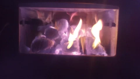

Here is the summit burning on low. This is about 45 min after reload. 3 pieces of boxelder maple, and 4-5 smaller chunks of plum. How does this burn look? Does it look normal or does it need more air?

Normal, even less air looks ok.
