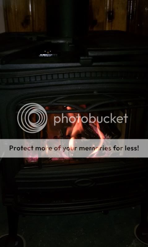

Not the greatest picture but here is the first fire.
Reactions: raybonz
Congratulations Murph. It sounds like you are doing fine. I have our thermometer placed as certified noted above. That is, under the trivet, so that it is just visible through the rearmost slats, close to the flue pipe.
I put it pretty close to the corner of the trivet closest to the pipe so it is just visible under the trivet, hopefully I am getting an accurate reading there. I had it to 600 last night and could smell the curing throughout the house. So far I have walked my wife through loading it while talking to her on the phone and she has kept it going so far today.
