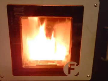

Fahrenheit Technologies Endurance has the largest viewing window.

Large Window. Large Flame..
