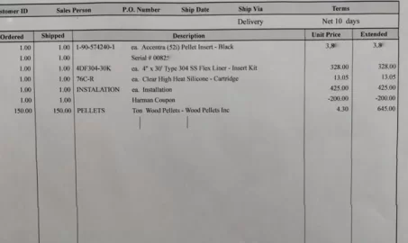

i'm not a contractor, but i can tell you my numbers that i got for an insert and chimney liner install, in the Greater Boston area.
i'm getting a 4" liner, in my 25' chimney, installed with my stove insert and it will cost $1100 for everything. I got the same estimate at a different store for the same insert. So $1225 for you doesn't sound completely out of the ballpark.
I would get another estimate or 2 if possible, that's the only way i think you can really tell if your estimate is right.
Reactions: Joe B One925
my install .... included pellet delivery $766
