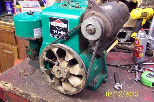

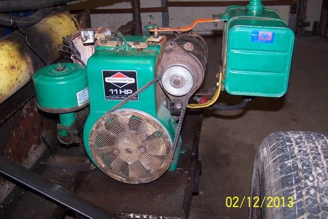

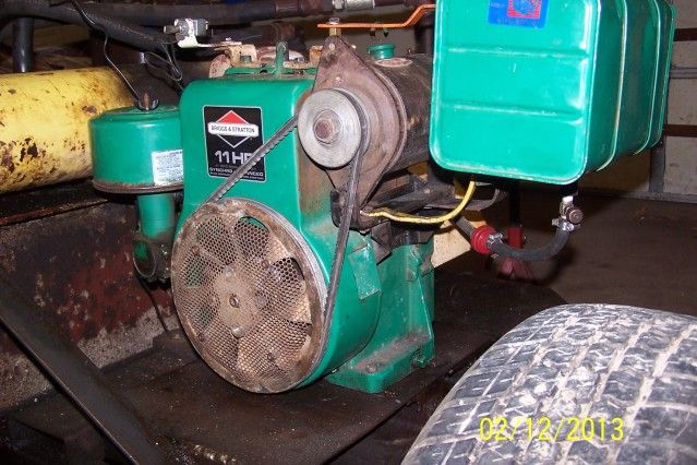

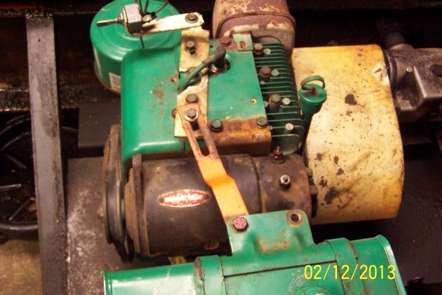

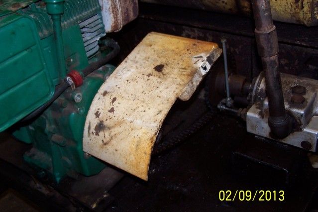

    this thing is a bear to get started when the fluid is cold. the pull start had to go , so i came up with this .
    [IMG]
    [IMG]
    [IMG]
    [IMG]
    chain cover
    [IMG]
    Scotty Overkill likes this.

    Now you just need some big-azz lights for that starter/genereator to power!

    I am a BIG fan of electric start on engines that have a tendency to sit for awhile. Yep, that old delco is just screamin' to be running some lights.

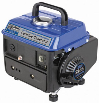

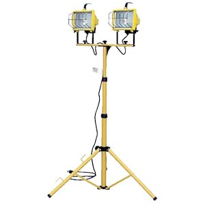

    Hah!, You what's cheaper and easier? HF 800 watt 2-stroke genny and one of those Halogen work lights on a stand. Get the twin 500 watt setup and swap the bulbs out for 250/300 watt units. Works great and you'll get sleepy before the lights go out. Little genny goes a long time on fuel!
    Should cost about $100-$120 total (get the genny for $80 with coupon/on sale, Light stand is usually $20-$30, Bulbs can be had for $2-3 bucks) and you get to use the lights/genny for other things. Pretty quiet too, good for night stacking!
