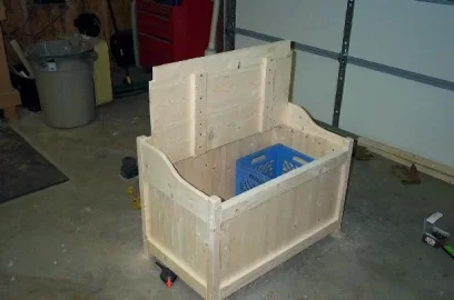

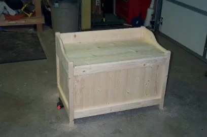

    Attached should be pictures of a wood storage box I made for my living room. It uses #2 grade pine lumber for a rustic look (and because lumber has gotten freaking expensive). I need to putty the screw holes, sand it and paint or stain it. I would like to line the inside walls with some kind of sheet metal. I found a roll of roof flashing at Lowes for $15 that I think I can work with. The intent is to create a surface that will make it hard for some bugs to climb up and out of the box. Jut wondering if anybody has done this or thoughts on the idea in general.
    I usually remove my bark when splitting so I don't expect to have too many bugs, but still imagine I'll be dragging in a few critters here and there.

    Looks great! I would think the bugs can still climb sheetmetal, mabey of you lubed it up with silicone or something, and make a rubber seal where the lid and frame join. Thats a sweet looking wood box.

    looks great! What kind of jointing did you do on it, or is it just screws and buttons?
    Just wondering :)
    Also, you might consider just sealing it tight with silicon and weatherstripping the stop to keep the bugs in. But that's just my idea

    Corie - it is mostly glue and screws.

    Nice looking job. What if you could foam weather strip it to seal the bugs in with the lid closed?
    I doubt AL flashing will be smooth enough to pervent them from crawling out.

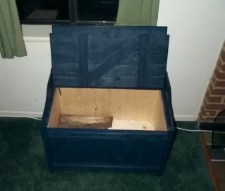

    Finally finished the wood box tonight. Took a lot of time to sand, stain, coats of clear, etc. I did notline it, at least not yet. I still think a metal lining or strip all the way around would stop someof the bugs, butnot all. Regardless, I sealed all the corners and cracks with silicone so none will be slipping out that way. The lid has just a tiny bit of unevenness to it so bugs could slip out the top - very annoying given the time I took to assemble it as even as I could get it. It's pretty minor - I'm just being sensitive since I made it and know all the flaws. There are a few others but I'm trying to pretend they don't exist :)

    Nice box. In the second pic, I see there's a couple of splits in there. One thing I've found convenient with my box is to put the wood in it standing on end. That way you don't have to worry about "rotating the stock" like in a grocery store. That is, you'll never end up with those couple of pieces on the bottom that you just never quite get to because you reloaded right on top of them.

    I have enough cherry and stained wood furniture in this room so I used "Minwax Water-Based Wood Stain" which essentially looks like watered down latex paint. It is actually a very dark blue, not black. My stove is black so I wanted something a little different, although they do offer a black called onyx. I blatantly stole this design from a picture I found online. All I had to do was figure out my dimensions and how to build it.
    Turns out it is a bit too large now that I have it in my living room. I don't know why as I measured and eyeballed the resting spot and figured those dimensions would fit in there good. Oh well. I can always put it somewhere else in the house if i decide it really is too big. I thought of the turned down metal but figured I'd slit my own wrist on it day 1.
    I put a couple coats of clear coat on it for scratch protection. My cats will be hopping up and down on it and those spaz cats sometimes try to run faster than their claws can find traction. I will be abusing the inside though - unceremoniously dumping wood into it. Good idea about standing it vertically but won't work now unless all pieces stay 16 or under.
    It still cost $100 easy by the time you factor in wood, stain and sealant. Life is getting expensive. I'm going to build a far cheaper bin for storing additional wood on the porch. Plywood or even pallet planks will do just fine for that. In fact a rustic look is preferred. Probably put some fet on it to keep it off the ground an inch or two.

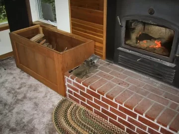

    Very nice box. Mine is not so fancy but I've got a feature that you might consider adding:
    I put mine on wheels. There are six big casters under the box. When I'm out of wood, I roll the whole thing over to the door, and load it up again. It works great. No traipsing back and forth across the carpet with armloads wood. It cuts the loading time in half. With six casters, it isn't too hard on the carpet.
    I ended up not putting a cover on mine, because that would have added to the weight. I haven't noticed a problem with bugs, though that concerns me.

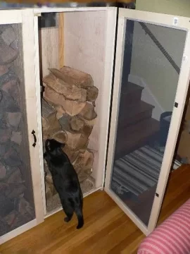

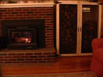

    Here's the picture of my Armoire. I'm sure Wahoowad is getting a laugh at how simple it is, as Wahoowad is is a good carpenter after seeing the details he put into his piece.
    I designed it to be these two compartments here, AND I made a top section also with two smaller compartments that were to store my smaller sticks, kindling, news papers, matches, and branches. I didn't realize how big I'd made the bottom piece. The bottom by itself, is about as big a piece of furniture the room can handle. When I put on the top also, this Armoire turned monstrous, closed in the room, disrupted our open floor plan and we decided the top had to go. So, off it came and sitting in my basement. My kindling etc. sits in a sort of magazine rack near one of the couches now. The size of this is 4'Wx5'6"Hx2'D.
    You can see a big open square cut out in the back on the top where some wood was taken. That's for the muffin fans I originally planned to put in. If I had a stove, probably would do it. With an insert and my blowers on it creates a nice gentle air flow all through the house that air flows through this Armoire to get to the insert which seems to do the trick. You can't see the 1" holes all through the back for increased air flow, they're covered by the wood and from the middle down.
    I wouldn't have made the sides of plywood if I could go back. It bows easily and I had to add braces right inside the door. You can see them on the left & right with the door open. My father said planks would've been better to stop that than plywood.
    You can also sort of see my white gasket on the inside around the door frame that stops bugs from being able to escape, though it's not easy to see with unfinished light maple and white gasket material. That works well, so far this winter, only 6 bugs have found their way out and into the house. I'm guessing their life span isn't long once the wood warms up, as after 3 days when I open the door there's none to be seen or waiting to come out. Only 1 mosquito this winter has escaped into the house. That cat was dropped off on our porch one day and the wife made it part of our family. It loves the smell of wood.
    Nothing extravagent, still need to finish or paint it, still needs trim. All made of 3/4" maple finish grade plywood for the outside, and regular 3/4" plywood on the inside to seperate the two compartments. The doors 3/4"x3" maple made by my father (thank god, you have to know what you're doing to make a screen door corners fit and be strong, and they need to be exactly all the same within very high tolerances because even the smallest amount off, and your doors will be out of square or the back piece sticking out more than the front, or a gap in the frame (my father says you can just put sawdust into some wood glue, fill in any gaps, and sand but it's better not to have to)). My original plan was to stain it, but now I'm not sure if I'll do that or paint it. So there we are.
