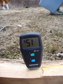

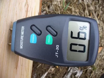

  1. muncybob Minister of Fire
    joined: Apr 8, 2008
    1,788 posts
    Near Williamsport, PA
    Most of the wood in my shed has aged about 2 years so I knew it was fairly dry. An ash split was around 17% and a maple split was around 14%. No idea how accurate my meter is but I knew from the sound of them that they were dry.
    Now what surprised me was a cherry split that I tested. It has about an extra year seasoning on it vs the other 2 but it came in at 9%! I didn't think we could get that low a figure in this area with the humidity most of the year. It will be interesting to see what the older wood will come in at mid summer as I expect to still have plenty of 3+ yr wood remaining in the shed after this heating season is done.
    Yes, the wood measured were fresh splits.

  2. PapaDave Minister of Fire
    That's too dry. It'll burn too fast.
    Don't use it.
    I call a do over.:p
  3. Woody Stover Minister of Fire
    joined: Dec 25, 2010
    3,387 posts
    Southern IN
    Yeah, that's bogus. Can't be that low. Must have been baking in the sun. I call shenanigans. ==c

  5. muncybob Minister of Fire
    joined: Apr 8, 2008
    1,788 posts
    Well, the shed's open side does get full southern exposure...but that cherry split was so far back in and up high that I doubt it got much UV radiation ;)

  7. Jack Fate Feeling the Heat
    joined: Jan 17, 2013
    268 posts
    Northwest Ohio
    Was wood tested cold?
    My meter reads about 4% lower when cold checked

  8. Backwoods Savage Minister of Fire
    joined: Feb 14, 2007
    24,148 posts
    Michigan
    Bob, we had some that was measured at 8%. So much for the idea wood can't get below the average humidity in the area.

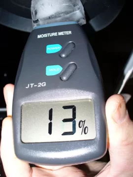

  10. muncybob Minister of Fire
    joined: Apr 8, 2008
    1,788 posts
    Yep, the wood was cold...so was the ice cube :)

  11. Scotty Overkill firewood hoarder
    joined: Sep 24, 2011
    6,814 posts
    central PA
    It'll be interesting to see what those same splits read when warmed up. Maybe take 'em in the house, let 'em acclimate for a day or so and re-read them........
  12. muncybob Minister of Fire
    joined: Apr 8, 2008
    1,788 posts
    OK. I never gave the ambient temps a second thought. After they warm up I'll measure the split, after a resplit of course.

  13. Lumber-Jack Minister of Fire
    How long have you been seasoning that ice cube? Because I think it's ready to burn! ;)

  15. muncybob Minister of Fire
    joined: Apr 8, 2008
    1,788 posts
    I think if I would have stacked correctly and covered the cube it may have come in at 10% :)
    My MM was just a cheapie from Amazon. I'm sure it's not real accurate but it does get you in the ballpark.

  17. muncybob Minister of Fire
    joined: Apr 8, 2008
    1,788 posts
    Well, I'm not sure about the theory on cold wood measuring lower on the MM. Took a split indoors 2 days ago, placed it in the most humid room we have at this time of year(lots of plants) and stuck the meter into it last night...about the same reading. If I remember to I will look for another piece of cherry from the same stack in mid summer(gets very humid here) and try again.
