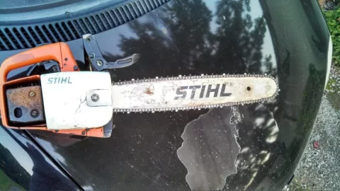

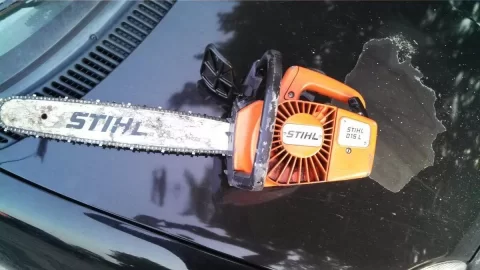

Its a STIHL 015 L! Pretty pumped. Only s bit of rust. Chain had no rust and was even a bit sharp. More details and pictures to come tomorow. Typing on my phone is annoying.
Quick facts:
Got it to turn over 2 times and run for about a second or two with a bit if fresh gas.
Think it needs a new plug because would not fire with starting fluid.
It had old gas in it for about 4 years or so.
The pull chord wants to hang out after I pull it.
Any tips for a rookie would be appreciated.

Here she is on the hood of the firewood truck ;)
Going to try and find the manual tomorrow and start working on it a bit in the morning before I go to work once I get it. I am very busy so it will probably take me a while to get it going. Any guesses on how old she is?
Nice...very retro looking
1973-1983. Neat little saw. I can see where it could be handy if a tree was down. You could easily walk beside it and trim the small branches to make room for the big boy. I hope I don't develop that CAD syndrome I have been reading about. IF my dad picks up a new back up saw it will be 3 chainsaws in 2 weeks. LOOK OUT. LOL
