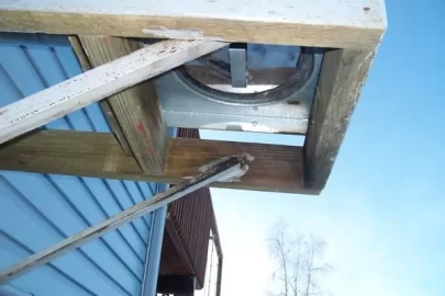

Worse case was one winter after a vacation we came home to -15°f with a large "high air pressure" weather front.
I had to pull the chimney "clean-out" plug on the bottom of the "T" outside of the house . Lit some newspaper in it, good to go.
