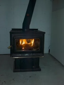

Here's a pic of the freestanding Summit.
I don't know why your front temps are higher than your top temps though. I observed the opposite on mine.
  • [Hearth.com] Question about a Summit Freestander
On the insert the decorative bay top is not the actual stove top. There is an air gap between it and the stove top so it won't get as hot.
Use the above the door location for your guiding stove temps and you will be fine.
