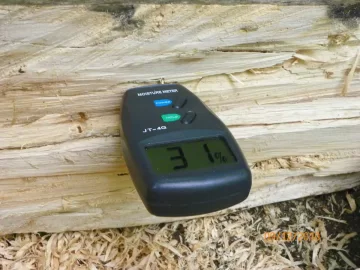

chris-mcpherson said:
I got the meter yesterday and am a little surprised. I tested some wood that I thought would be borderline and it's showing 10%-15%. I then tested Red Oak that was cut down less than3 months ago and split less than 1 month ago and it's showing 20%-25%.
The whole reason I got the meter was because I assumed the wood I have wasn't seasoned enough because of the tough time I'm having keeping a good fire going without the draft controls wide open. The next morning I have chunks of wood mixed in the ash... this tells me I have wet wood. Am I getting inaccurate readings because of the FSP your describing? Is there a standard that can be used to test the accuracy of my meter?

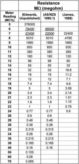

Calibration
Most resistance moisture meters use Douglas-Fir (Pseudotsuga menziesii) as their default species calibration. Table 2 shows the Australian resistance values used as the Douglas-Fir standard (Edwards, 1974 and AS/NZS 1080.1: 1997). Note, there is a slight discrepancy between the figures shown for meter readings of 6 and 7 % between Edwards (1974) and AS/NZS 1080.1 (1997).
Confounding the issue of Douglas-Fir calibration, is that different world regions and different meter manufacturers can, and do, use different standard resistances for Douglas-Fir. To illustrate this point, resistance values for Douglas-Fir (Coastal) from James (1988) are included in Table 2. Skaar (1988) confirms that these are the resistance values used by most US made resistance moisture meters. Many meter manufacturers do not actually provide or specify the standard resistances they use as their Douglas-Fir calibration.
The table below contains the resistance data for Doug Fir from three different sources. As you can see, two of them concur with each other, the third is way different. According to the text quoted, the third column (James [1988]) contains the resistance figures that are used to calibrate most American made meters (i.e. Delhorst). Where was yours made? :shut:
At any rate, if you accept that yours was probably calibrated to the U.S. standard, you can go to Radio Shack and get 2 or 3 resistors that correspond to the values of interest on the tables and see if they agree with your meter. For example, a 600 KOhm resistor should give a reading of 24% MC on your meter, 2.14 MOhm should read 20%. etc. But I bet you're not likely to go to all that trouble. ;-)
