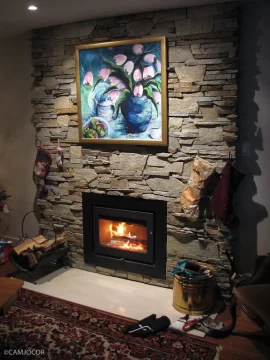

I can't check flue temps since it's an insert. With a laser therm the interior of the box is 500-600 plus, and the top of the door is externally around 350. What concerns me is the stone above the fireplace is hot as one might expect and drops off as the distance from the insert increases but it is still 130 degrees at 25 inches above the insert. Is this concerning? The same applies to the hearth in front of the insert. Similar temps 130-170 closer to the door. The door is 10 inches plus above the floor of the hearth. I have attached a photo for visual context. The picture is 25 inches above the door.
The interior walls behind the insert are not warm so there is no conduction through the wall. The chimney is clay tile lined with a SS liner (no insulation, no block off plate).
