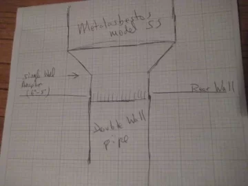

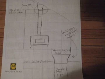

Can I use a single wall adaptor to connect Metalasbestos Model SS to Double Wall stove pipe. My combustible clearances are within limits. I was using the adaptor in the previous installation. Now, I'm wondering if using Double Wall stove pipe changes anything regarding the adaptor.
I'll have to wait another week if I get a Double Wall adaptor.

I think you should use the proper adapter. This is a piping system. The double wall adapter will give a positive connection between the ceiling support box and the connector pipe. It'll look a lot better too.
You're right - I should have the proper piece.

Our old metalbestos setup was single wall, but this looks similar to the way Simpson does it. If so the adapter is like a male to male connector that sits inside of the class A and double-wall connector.
But I am wondering about your pipe. Is it also transitioning from 8" to 6"? If so, it will need a reducer.

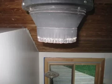

Yes, I'm going from 8" to 6" pipe; and Metalasbestos Model SS ceiling pipe (class A?) to EXCEL (ICC) double wall pipe.
My shop guy said he wanted to order an adaptor for the Metalasbestos, then the reducer to connect the two pipes. And, I was unconvinced that he was sure if the reducer was single or double wall. If it's single wall, I'm doing all this to get back to where I'm starting.
The new EXCEL double wall pipe fits nice and snug over the reducer I have now photographed above. I'm wondering if this is not a good set-up. I'll talk to Selkirk.

I think they'll tell you to not mix flue brands. These are systems with parts designed to tightly couple and lock one to another. The coupling system is not standard between pipe brands.

Excel is good pipe, that's not the issue. I don't know if this can be done well. Your dealer should have informed you about mixing brands. I'd ask them next. Maybe they also sell Selkirk pipe and can make it good.

It looks like it was already setup for single wall. Whether clearances of 18" to combustibles are honored is hard to see from the picture. If they are you should be ok with single wall pipe.

Update: Selkirik just told me that as long as my ICC double wall fits over the connector to the Metalasbestos chimney fairly snug it's fine. He said that the connections do NOT have to be airtight (because of the negative draft).

Yes, it was set up for single wall. That's what was there when I bought the house. Now, I'm installing a new Regency stove and trying to make everything adhere to code. I bought double-wall pipe because my set-up was half an inch short of clearance requirements for single wall pipe. The rear stove wall height ends just below the bottom of the chimney connection so there is lots of open space around the single wall reducer.
