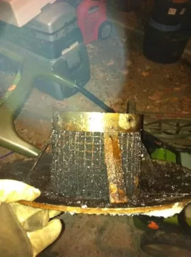

The cap has 1/2 inch mesh, I've attached a pic.

Problem found!!!! I guess I shouldn't be so worried about burning too hot? The wood should be better next year too. I cut, split and stacked it this summer so it only has about 6 months of seasoning.

Mmmm... yes. That's what I was thinking it would look like when you first said it was black and tar covered. Stove doesn't burn so well when the cap is totally clogged.
Burn hotter and / or better wood and that will not be as much of a problem.
