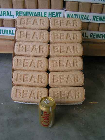

    Took some photos after I got done stacking them..
    Here is a pic of the bear brick packaging next to a can of coke to show size...
    [IMG]
    And here is a picture showing 2 tons of bear bricks along the side of my garage wall; With little square bricks - they stack quite nicely into a very compact space.
    [IMG]
    The stack is 24 inches deep - 8 feet long and about 4 and half feet tall... This is 2 tons - the equivalent of 2 cords of fir in a pretty tight space! :)
    jeff

    Jeff Thank you for the pics.How many cords of wood do they(2 tons) Equal????

    I think your math is a bit off. The flats look to be 16" x 24" each so the bulk of your stack is 16 inches deep by 12 feet long with the exception of the 5 flats above the foundation wall.
