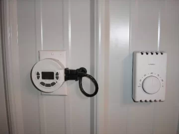

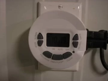

Well here is what I'm trying and so far so good. The house Temp goes up from 71 to 74 @ 4:00AM them goes back down to 71 @ 9:00AM. Then goes back up to 74 @ 3:00 PM and goes back down to 71 @ 9:00 PM. (now I know some have there own idea about that hole thing) But When I hooked in my 1200 sq foot shop of slab heat I was worried about the same thing. I didn't want to starve the house to heat the shop. So what I did is went to Menards and bought a indoor 120V timer. The slab is wired as follows: power comes from the breaker box to an outlet where I have the timer plugged into, the 120V thermostat is them plugged into the timer and them wired to the pump. I have the timer (which has up to 20 set times on it) set to turn on at 8:00AM to 12:00AM then again to turn on at 5:00PM to 9:00 PM. How this all ties into each other is that I fill the boiler now 3 times a day by adding the shop to the system. I fill in the morning and after I get home from work and usually have to toss in a couple pc's before bed. So the house is going to be just off a cycle by the time the shop is allowed to come on. And it is right after I just filled with wood. Seems to be working well so far and didn't cost a hell of allot. I'm sure there is other ways but I'm not an electrical goo roo. Oh and I decided not to run the loop constantly circulating, seemed like a big waste to me both on the added pump needed and the heat loss.

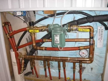

Thanks for the info on the pump. I did not know that. I don't have much choice in the matter due to the space I had to work in. The other thing is why the heck would they put the sticker on the pump that way if your not suppose to mount it with the lettering so you can read it. LOL

This way, others may benefit! Looking at the photo, it looks to me like you have enough room to swing it 90 degrees so that the sticker is facing up.

This way, others may benefit! Looking at the photo, it looks to me like you have enough room to swing it 90 degrees so that the sticker is facing up.[/quote]
Good point!
