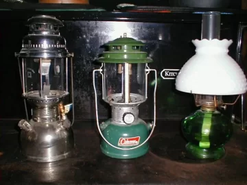

That picture is deceiving, the lantern is the largest I have and the brightest by far. And I collect Dietz barn and railroad lanterns, so have lots. The original Petromax Rapid (400 watt, that the BriteLyt 500CP is modeled from) from Germany is shown below next to a Coleman (100 to 150 watt) and table lamp (approx 50 watt max?) for comparison. Those 3 are the most used at our off grid log cabin. The Rapid takes the cheapest mantels that are very course, and burns anything flammable. Coleman fuel (naptha), mineral spirits, gasoline, kerosene, diesel. This military version was originally made for benzin (gasoline) and later banned the use of gasoline. Detailed article from pressure lamp collector here)
http://www.petromax.nl/petromax_tale/petromax_myth.html
They are THE lantern to go to for light needed outside like a flood light, or work light, but are also the loudest as far as hiss for indoors. The table lamp on the right is quiet and uses a 1 inch wide wick, bright enough to read by. So we use two on tables and Dietz barn type lanterns hanging for area lighting. (in our electrified house as well) 3/4 wide and below wick lamps are getting into eye strain for reading.
RE: Lanterns and batteries Petromax on left without reflector hood.
They get HOT, about 8,000 BTU and can boil water or cook with plate on top.

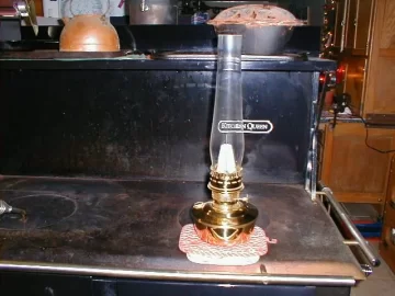

This is the "Shelf" model in brass. They are made in aluminum, nickel plate and different colors of glass. The "Table" model has a taller stand under the font. (tank)
I chose the lower style to be able to hang with a clamp type hanger over the cookstove and this becomes our kitchen light. They require a shield above chimney when hanging.
RE: Lanterns and batteries Discontinued Shelf Lamp in brass.
RE: Lanterns and batteries Table Lamp in brass.
