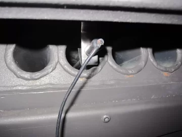

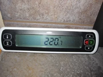

How can you tell the heat output is less? I saw you said you were using an IR thermometer and measuring the backplate? What part are you calling the backplate? The best way is to use a meat thermometer and mount it into a convection tube. Make sure it doesn't touch any metal though. This way you are measure actual output air of your stove. The temp of metal parts of the stove is irrelevant as long as your output air is hot. Here are some pics of my setup. I had to modify the mounting clip to fit into the slot above the convection tubes and bend it so that the probe is centered in the tube.

When you had taken the picture of the thermo on your stove do you know what setting it was on?

I'm not an expert on IR thermometer usage, but have read that trying to take temps thru the glass is flaky at best. Yeah, ditch the IR thermometer, they are just too finicky for the type of measurement you need to take. Too many variables using one and they can't measure the output air which is what you really need to know.
I took that temp on heat level 3, feed trim 2 combustion trim 3. That was using Blazer pellets. My current pellets, I get about 250F with heat level 3, feed trim 3. Also, if you're looking to compare to my #'s you might as well put the probe in the same hole. Mine is in the 2nd from the left. The left side of the stove is hotter than the right. Of course unless you are going to burn Blazers, your temps will likely be different. But at least you can check temps at different mag readings.
