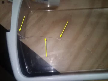

    Why is it so hard to fix something nowadays?? This was really frustrating!
    The gallon milk holder in the regrigerator door was craking and the white plastic rim top popped off.
    So before it was completely destroyed and unusable there should be an easy fix?

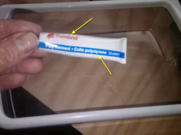

    So I sent for it and just tried it out today. It came in the familiar tube, looks like the same consistancy, the smell is pungent too!
    It does say polystyrene on the Label so it sure looks like the real McCoy!!
    Then I tried it out, you have to apply it to both sides so it will properly fuse together. I held it for 15 mins and it stayed together!

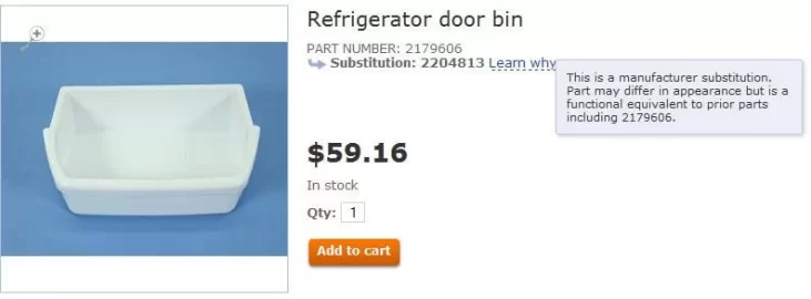

    It is a SearsKenmore ColdSpot 22 CuIn Refrigerator Model # 106.74259402.
    The Milk holder shelf is the same size as the other 2 shelfs and called "Refrigerator Door Bin" Part # 2179606 in Clear Plastic with a white cap along the top edge. The new substituted part # is 2204813 which is all white and will not match the other shelves.
    So my Imported Polystyrene cement is holding quite well now and I swapped it with another shelf that holds less weight!! This may get me by for a long time!!

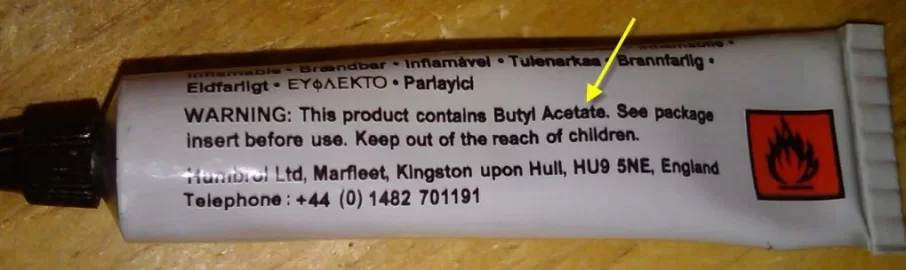

    BTW. On the back of the Air Fix Humbrol Polystyrene Cement I found the major ingredient.
    Butyl Acetate !! Click on Pic Below
