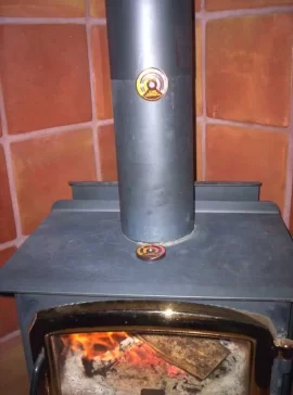

It sounds like you are running the stove at low temps. Can you take a photo of where you are placing the thermometer?

Hmm- I thought this was cool. But yeah- i'll snap some pics, I have one thermometer on the box and the other on the flue I'd say about a foot above the box.........

OK folks- I got up to 550* last night and the flue in the 350- 400* range, talk about reaching nirvanah. I took a pic of where I have the thermometers.................
