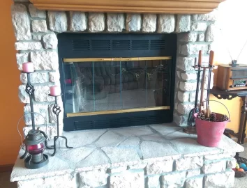

Secondly, I moved in to a home with a real crappy insert, a TEMCO TLC 42-4, and it's been terrible. The heat it puts off is bad, the fan is worse, and it sucks out air like a succubus dining in space. Which plays in to my biggest concern and main reason i'm looking to replace, is that when i'm not using it, even with the damper closed, so much air moves through it causing a temperature difference in that room.

-The opening in the fireplace is 44.5"Lx36.5"Hx25"D, which is bigger than the 42-4 specs..
-The room it's in is 500sqft with vaulted angled ceiling in a 2001 two story 2500sqft house with unfinished basement (+1000sqft).
-Heating the entire house is not mandatory, supplemental would be fine, though if the prices are close enough, the better output is always good just in case the furnace (heat pump + propane) goes out, or it's a real cold night.
-Air tightness between the inside and outside is my biggest concern, which is why I kind of like the QuadraFire http://www.quadrafire.com/Products/5100i-Wood-Insert.aspx but it's also quite bulky, sticks out, and it's more box than visual fire (but I suppose that's the point),
-Conversely to the above, it would also be nice to actually use the fireplace time to time. Open the door, enjoy the sound, possible to have a swing are to cook something in a dutch oven, etc. But it doesn't seem like this would be possible, if high heat and air tightness are desired.
