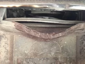

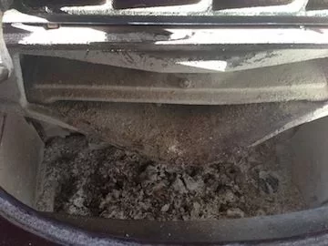

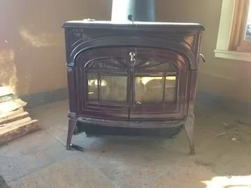

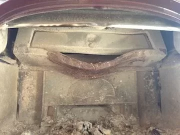

    IMG_0120.JPG IMG_0121.JPG IMG_0122.JPG IMG_0123.JPG IMG_0125.JPG The ID plate which would show the model is missing but I was assuming it was a 2040. But in looking at parts diagrams I am not sure if it is a 2040 or 2550. Here are some photos of the stove & warped pieces. Can anyone identify the model number from these?

    I have a 2550 and the throat hood does'nt look the same as mine, I don't see the pins on each end.

    OK hold up, that looks like an Encore non-cat model 1450. The 2040 is the 2-n-1 , with the removable cat. thing.
    SO forget the fireback kit idea. You need the damper housing part # 30002413, and likely the damper 30002389. Get the damper tabs and damper ramp w/ related hardware too.
    Be VERY gentle around the fountain assy too. It's delicate and expensive, tho w/luck you won't have to really deal with it much.
    Good luck and happy heating!

    That sucker is POACHED!

    Oh my lord... What where you burning in that thing.... spent nuclear fuel rods? :eek:
