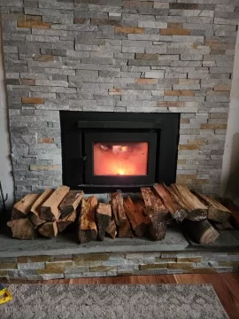

Usually requires cutting it and separating it from the chimney and to do that you have to take apart what's above the the fireplace to get to everything. I just went through all of that 2 years ago and this is the end result
