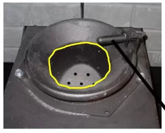

Yeah, there's 2 separate things that can be out of adjustment with the sensor...
1. The position of the ceramic cover (should be hanging 3/4 inch over the inside burn pot diameter highlighted yellow in picture)
2. The wire/sensor that fits into the ceramic cover has a tendency to pull out of the ceramic as the wire gets baked from the heat and stiffens up. You may have to tweak the wire a little to make sure the sensor can stay buried all the way into the ceramic cover.

Thanks everyone! I moved the thermocouple to only extend an inch over the pit. I also removed the top gasket on the door which I erroneously installed (another topic). The stove has been running normally since. I'm not sure which of the two things fixed it, but I must thank you guys for your input. This forum is great!
