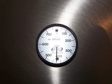

    I use these gauges for my stove top temps on both my stoves,,, from PTC Instruments. Has dual magnets on the back. I believe they are used to indicate pre-welding temps on heavy steel, as you can pay a little more for the same gauge with a certification.
