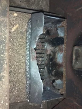

I believe you have the same problem as I had originally. The burn pot does not sit great and there is air bypass around the pot causing eventual pellet buildup.
I got a thin piece of rope gasket and literally ties it in a knot under the lip. Just be careful you don't use the thick rope gasket or your igniter hole may not line up.
I now only touch my stove when the ash bin is full and never run it over three, even them I am in high/lo mode. Setting five and you could roast a pig in your living room
The cleaning is a piece of cake. There are two traps, one on each side. I suggest looking up leaf blower trick and try it. Best way to ensure a clean stove.
Check out this pic....this is what I did to the burn pot. Rope gasket goes all the way around and is tied on the side.
