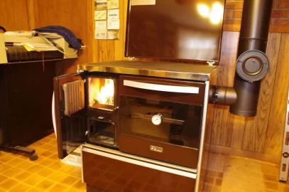

    tn_IMGP1664.JPG Does your wife love to cook? Kill two birds with one stone! www.sopkainc.com I have the little Royal 720. It takes very little wood and it's up to temp in about 15 minutes.
