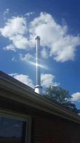

We do have a cap on the top of the chimney but there will just be times when it's blowing sideways that there's not much you can do about some rain getting in and running down. I really don't want it running onto the stove if I can help it.

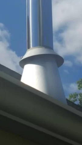

I've got Selkirk class a chimney also going through the roof, attic then to a slip connector through the cieling. I did go into the attic and fine a line or two where water at some point tan ran down the outside of the class a in the attic (or just condensation?) and then down past the metal top of the support box. But that doesn't really make sense to me either.
I can see the line where the water came out of the top half of the slip joint and then down onto the lower half? Again not talking puddles but enough to cause a spot of rust a little bigger than a half dollar over the past 6 months.

You need to caulk the seams in the class A pipe. I've seen this a lot, the newer pipe from Selkirk (the TLC line) has welded seams. The rep knew of the issue and agreed that caulking was was needed.
Ok thanks, it would be a vertical seam on the back face of the pipe that I'm looking to do correct? Do I need to go high temp or can I use a high quality clear silicone.
Sent from my SM-G920V using Tapatalk
Our house had older Selkirk chimney pipe that weeped moisture in heavy rain. I ran a bead of silicone down the vertical seam of the lower pipe above the storm collar and that ended the problem.
Thanks for the info guys. I'll get up tonight after the wife gets home and take care of it. The roof pitch is steep enough that I like to keep someone else around while I'm up on that part of it.
Got the bottom two pieces of pipe done, so half the chimney. Hopefully that takes care of it. Never been a fan of heights, getting better with them but the 12 pitch roof has me feeling like I'm sliding the entire time.
I have the exact same setup as you and experienced the exact same problem. I called the professional that installed it. He siliconed everything as stated above. Problem solved.
