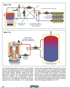

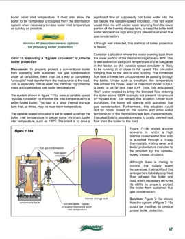

There are some piping arrangements out there that may be a bit misleading.
Here is the way to pipe a VS pump, along with the explanation, to provide absolute protection.
