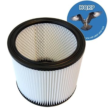

    So I after looking at all the suggestion of y'all. I did some searching on amazon and ebay and found the following
    http://www.amazon.com/gp/product/B008ERVR2G/ref=ox_sc_act_title_1?ie=UTF8&psc=1&smid=A3IZHOEADOGAP0
    [IMG]
    which is very similiar in design to PoolguyinCT's link but about half the price delivered. I will report back (if I remember :p) how it works so others may try it. Hey it comes with a free coaster with a picture of an Osprey, washable and reusable (or so it claims), PP compound filter is H12 filtration class and retains 99.97% of particles down to 0.3 micron ( I only know some of what all that jargon means but it had cool numbers and letters in it :) )
    Of course YMMV and I have not used this product yet nor am I representitive of this company (but they can send me freebies if they like ;) ) etc, etc, disclaimer, disclaimer, caveat emptor, disclaimer, etc.

    Kenstogie,
    I use a filter in my shop vac (looks like the filter you posted in your picture) with a drywall bag (Type H, I think). Absolutely no dust comes out of the vac. Been using this setup a few seasons and really like it. Usually clean the filter once a season. Just tap it and maybe blow a little compessed air on it. Probably use 4 bags or so in my 5 gallon vac.
