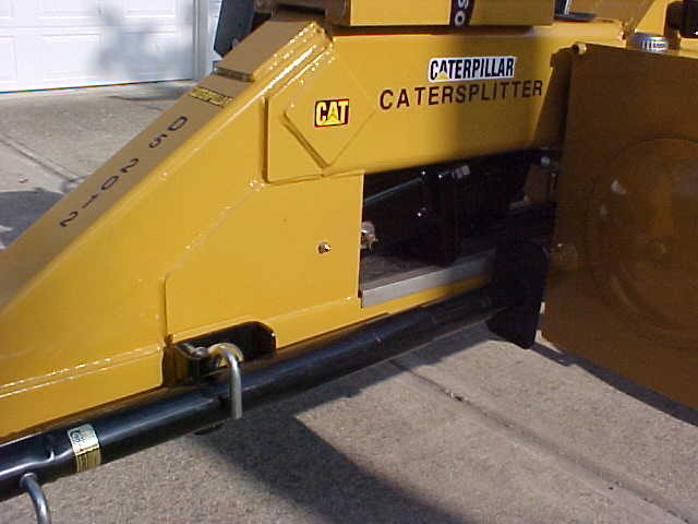

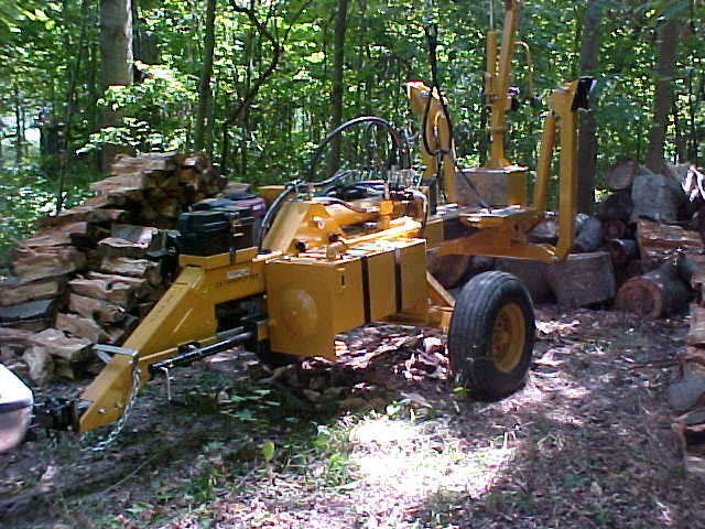

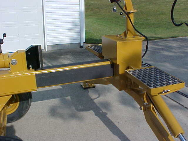

    First Post on this site and here is my splitter. 25HP motor, 28 GPM pump, 5 X 30 cylinder with adjustable stops. Dual swing away detent tables, stabilizer arms 360 degree swivel lift with cordless winch, 33 Gallon hydraulic res, quick attach wedges and full auto cycle valves. Built for the big stuff and does really well.

    !!! Holy wood splitter! Nice Kevin, very nice. Are you in the business of selling firewood? How long have you had that monster?

    4 posts
    Those pics are before I started using it earlier this year. I've run about 35 cord through it a makes it way easier as there is not near as much leaning over. Beam is right at 40 iches high which is perfect for me. We basiclly do not have to lean over to pick up the to be splits from the big rounds. We do not sell but have 160 cord under roof at the moment.
    [IMG]
    Here are some action pics for you. That is about a 40 inch Beech Round
    [IMG]
    [IMG]
    [IMG]
    I think I'll keep her ;)
