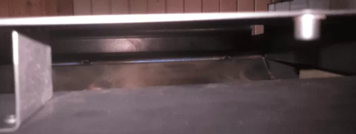

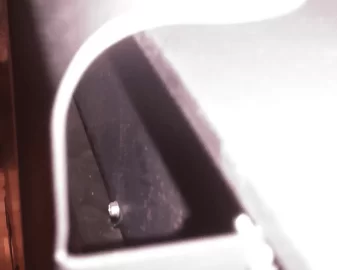

I tried to snap some pics peaking inside the back of my 4300:
Smell won't go away on new stoveSmell won't go away on new stoveSmell won't go away on new stove

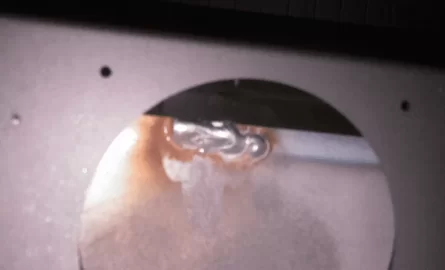

From the first picture, they don't appear to try to paint all their welds. This stove is only 2 weeks old. Happy to report most of the smell is gone from mine, though I swear it does have a faint odor of apple cinnamon herbal tea today. From what I've been able to see in mine, the flue collar is bolted to the top plate of the stove, not welded.
Reactions: mincus
Why do you say that?
I can see that it's stick welded, but what are you looking at that says 'flux core' to you?
(I am learning welding basics, sorry for the slightly off topic question. :). )
Flux core has 2 applications...stick welding as you already know and mig welding with flux core wire...both designed for dirty metal and windy conditions. The mig flux core wire is used with out a cover gas.
There's flux core that self shielding and flux thats dual shield that run with gas. Either way not the best looking welds

I asked him about the possible missing weld and he said that there shouldn't be one there because the weld is on the inside. No idea if that's true or not.
The weld is on the inside.
