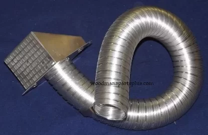

    Same thing will happen if you run a clothes dryer exhausting to the outside, kitchen or bath fan, central vacuum, power vented gas appliances, or natural venting appliances like in your case. Negative air pressure in the house has barometric pressure pushing down the chimney becoming your air intake. Cold air also wants to drop down chimney making an easy path. Closing off fireplace flue is only going to allow outside air to leak in where it can, causing drafts in the house. Like DAKSY said, an air intake close to the stove or appliance that requires air allows outside air into the burner without the cold air migrating through the house. Similar to a dryer vent terminating near the stove. Yes, you will feel cold air coming in it. It is being drawn into the stove, not cooling the home like it would coming down the chimney upstairs or from every crack it could find in the house, and moving through the house towards the stove. I've installed these to find the customer thought the cold air coming in was bad, and stuffed them shut.

    Thanks for the replies. Would it work if I cracked open the slider door which is about eight feet from the stove until I bring in the fresh air the way you described?
  5. coaly Fisher Moderator
    joined: Dec 22, 2007
    1,028 posts
    NE PA
    Yep, That'll make your stove go easier too.
