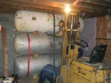

These are 330 gallon propane tanks. They are 30" in diameter and are 9' long. Fit right through a standard doorway.
Really nice setup there. What type of modification is need to use the propane tanks? Do you have to drill and weld threaded bungs on them? I thought about (2) 250 gallon tanks set on end if I could find them used.

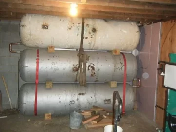

Yeah, I drilled a 2-1/2" hole on each end (one low and one high) with a standard hole saw and drill. Just use plenty of oil. I then welded 2" black pipe nipples on the ends. I only had 8' of clearance to stack them, so I was forced to stack them on their side with the feet against the back wall, hence the wood cradles that I made. They will be eventually secured with 4x4 anchored into the concrete and the rafters which will double as the framework for my insulation box.
The guy I bought them from struggled to get me three of these bastard sized tanks, but had many of the vertical 250 gallon. The only problem is that he is out of the tank business.
That's a nice set up you have there b.b. 2010. That is the first time I have seen three tanks that size set up like that. A nice way to get that much storage into a basement. Are you on-line with the system yet? How are you planning on insulating them?
I do plan on insulating them after they are air tested and I have the bugs out of my system. I am not up and running yet (A sore subject with my wife :red: ). I am done with all my plumbing, but am just beginning the electrical which I am not very well versed at. As I mentioned, I will be installing 4x4 vertical supports, and packing insulation in between. I was able to drive a small fork lift into my basement to put the top tank on.
