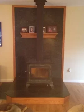

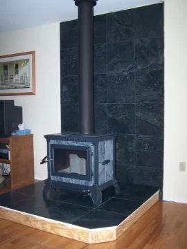

Responding to firefighterjake about soapstone hearth. I built my hearth and back wall using 1/2" thick 16"x16" soapstone tiles a couple years back. I posted here briefly about construction after building, but haven't really posted about this since.
Couple pics: One picture is of finished hearth w/trim and mantle (double wall interior pipe, so clearances are more than minimal) from phone pic so poorer quality, other higher quality pic is from before trim was added.
Overall, we have been really happy with the outcome. We use the stove as sole heat source for 1650sq ft ranch (we have oil furnace but don't need to use it with stove). The hearth/surround definitely does hold the heat well after sustained stove operation, but takes some time to warm up as one would expect. Area directly in front of stove front glass door, as well as areas drectly behind stove on hearth and wall get very warm, and radiate heat for significant periods of time once warmed. The hearth has two layers of 1/2" cement board bonded with thin set under tiles, the wall has single layer of 1/2" cement board behind the tiles. Overall a less than scientific review I realize, I can repost this winter taking hearth and stove temps w/IR and duration times if anyone is interested. I don't remember the tile weights off top of my head, but seem to remember a rough estimate of 400-500 pounds of additional soapstone on the hearth (i.e. approx. weight of a second Heritage sitting there, although obviously not being heated to same extent as stove). Again, I can re-weigh a tile and port w/ exact mass of stone used.
I don't think this hearth setup necesarily shines after a single stove firing in shoulder seasons, but rather after several successive firings during sustained burning top get tiles completely warmed and then allow to radiate to help even out overnight temp drop in house. As to durability, the soapstone tiles have held up well overall. Couple minor scratches here and there from our dogs running across them, but then again the tiles are on a raised hearth so no human foot traffic. I tried to use one of the harder varieties of soapstone (Beleeza) as there are also some softer ones available. Haven't dropped a big chunk of firewood on them yet so can't attest to that, but at some point I am sure I will. Can't say this setup is any better nor worse than any other type of stone hearth, just that it works for us and we are happy thus far with look and performance.

Jim . . . thanks for posting and updating us . . . and proving that I am not losing my mind . . . I thought I remember someone doing their hearth in soapstone . . . and for the record I still think it looks fantastic!
Looks great!. I'm envious. I rather wish I had not listened to advice, but had installed soapstone as was my choice. I have to admit I have dropped a few chuncks of wood on the hearth. Please post what the results are if this ever happens to you. And thanks for posting. I admire your install, and regret not having all that warm heat radiating into the room....
