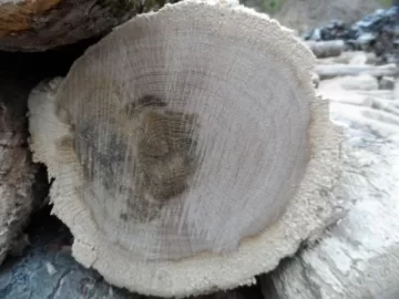

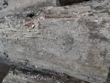

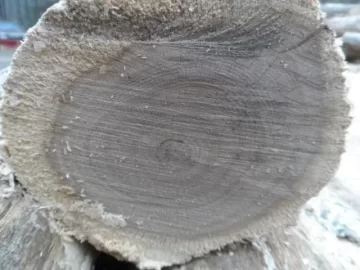

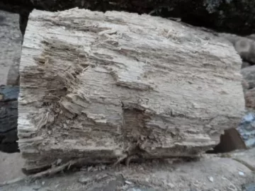

    Note the photos of oak wood with a punky outer shell. This stuff has been dead standing for god knows how long. Needless to say, many folks assume since stuff is dead and lying or standing, that it must be dry. My point is unless split & stacked for 2 years minimum, preferably 3 years for most oak and other similar hard woods, it ain't dry. Some of this stuff may be ready in a couple years, but most will need 3 to achieve the desired dryness I want.
    I don't care if it is dead standing, or dead and cut into rounds. Around this house, it ain't started drying till split & stacked.
    Those that have burned truly dry oak and other nice hard woods, know the real heat potential of these woods. Those that just cannot get the stove to temp, and the heat from the load.... don't have as dry as wood as they think. It is a shame to waste heat and energy drying out a load of wood that is not ready. Makes for a lot of unhappy burners. Before you blame the stove, check the wood.

    Those pics also show the potential of trees on the ground that look like a piece of chit and you would think they were rotted through and through. Lots of good btu's in those rotten 'looking' logs. Good post.
