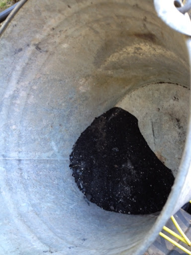

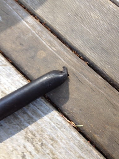

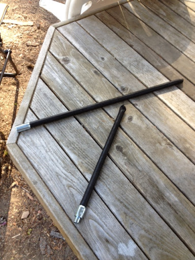

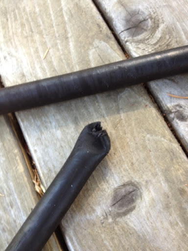

    I ended up snapping a rod when I cleaned today. It wasn't one of the white rods that came with original kit, but the black or dark brown rods that came in the add-on kit of (2) 3 ft poles. It seems to be made of a different material and like Brotherbart said is less flexible.
    A few things I should have done differently:
    • I forgot to use a drill/driver with a clutch. It simply bound up and then snapped it off.
    • I think some of the poles had dropped down in pipe some and into stove and when I started again it just spun up the weaker poles inside firebox. The creosote fogged over the plastic so I didn't have a good view in firebox at the time. I was amazed at how the white poles survived the contorted spin but the black pole just twisted off. I think in addition to bunching it up I had reached cap and maybe that threw a little strain on it as well as it was beating around up on top.
    Glad I didn't use the black poles as the first rods. Far easier for me to retrieve with it snapping at bottom. In this case just inside the firebox.
    Less creosote than last year. Hopefully I can cut it in half again. I'm going to be burning douglas fir, cherry and energy logs this year.
