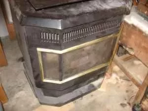

DemonGT said:have alot of soot building up on my window. what would cause this?
DemonGT said:good to know that is pretty normal, what is the best way to clean it? i have some fireplace cleaner that works good but the fumes burn my eyes
Don2222 said:Hello
First - Please tell us what kind of stove you have. Even better if you add it to your signature!
Looks like a Pelpro Bay View Insert with an AccuTron II control. If so does it heat well? I just picked up a Pelpro FS Bay View!
Second, Pellet stoves will soot up more easily on a low heat setting and if it is very mild or warm outside.
If so you must increase the Intake Air and I do know that the Air Intake damper on the Pelpros are very touchy!
So How old is the unit? (See inside lid date stamp)
What kind of wood pellets are you using? Did you do the dollar bill test on the door gasket to check for any air leaks?
DemonGT said:Don2222 said:Hello
yes, it is a bay view insert, it heats very well. my house is just over 1800SQ feet. the auger seems a bit noisy but other then that we
really like it. the unit is alittle over 4 years old. we just bought this house last spring and the previous owners who built the house new
4 years ago had it installed when the house was built.
have not done the dollar bill test, i am burning indeck energy pellets
DemonGT said:recently iv been running it at feed rate 1 and fan speed 1, some times feed rate 2 and fan 2. so lower settings
