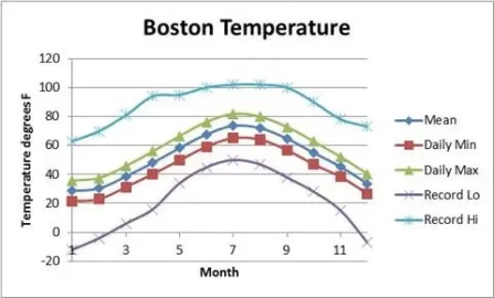

    It sounds like your goals are realistic. I think you'll be fine with one unit for starters. You have a woodstove for primary heat in cold. If you live right on the North Shore your weather is tempered a bit by the ocean. That means that over 90% of your winter temps are over 20F, right? If so, you are well covered for the first floor heating with the heat pump. Give it a try for a season. You can always supplement with an inexpensive electric space heater if needed, but I think you'll be fine and quite impressed with the unit's performance.

    I agree with BG....the one unit will fail to carry you solo during some periods of real winter, but will still provide the lions share of seasonal BTUs if you need/want it to. See how it works out, and get a second mini unit if you don't want to burn wood for a couple months, or fire up a couple space heaters.
