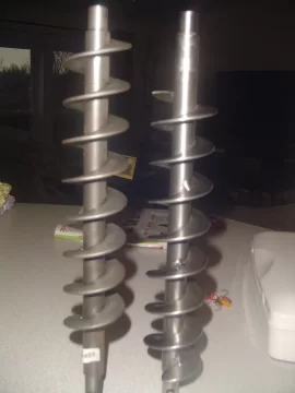

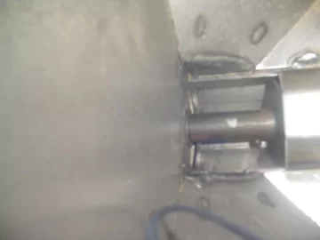

    Ok...so update on my auger. I talked with St. Croix, they said they had talked to my dealer, and everything was all set.......so i waited a week, called my dealer and no auger in sight.....remember i have an email from them saying everything was ALL SET.
    So he called St. Croix and they had lost the fax on the original warranty so we refaxed and they shipped the auger. I got it on Friday, so 2 weeks later, and lo and behold its the wrong auger. The spiral on the old one is towards the bottom of the auger and the spiral on the new one is positioned towards the top of the auger. The one on the left is the new one and the one on the right is the old one....also attached is the picture when i slid it in the furnace...there is no auger showing in the opening and the old auger fills the opening...
    grrr i am so frustrated right now i cant begin to explain...propane is damn expensive and no one seems to care except me.

    Well I've always maintained that a good spare parts bin is called for when using a pellet burner.
    I sympathize with you but saw it coming.
    Get thee to a local machine shop they can fix that bad auger so it works.
