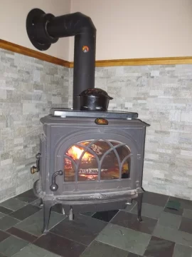

Not sure if it is 4 feet . . .
  • [Hearth.com] Stone chimney and wood stove pic picture?
