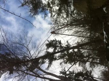

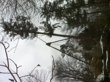

    Fabricated a 45 ft. "lofting jib", hinged at bottom, lowered over tree at 45 degrees, rigged to trunk, pulled with skidder. Pics are pretty cool.

    We'll cable it down. We wrapped it with something similar to "cedar breather" two thirds of the way up, then anchored cables into rocks. The tree was moved into place about ten years ago. I work on a large estate and yes, they want to TRY and save the tree. The whole operation took three months from planning to fabrication to execution.
