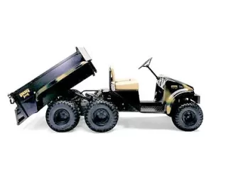

    I've done the direct wood shed storage for more than 15 years. But good ventilation is extremely important - air movement directly through the stacks and stacks raised up off the ground. I also follow the FIFO method, emptying and refilling the shed in a circular pattern.
    Minimal handling and rehandling pays big dividends as age creeps up on the body. I now split in the same place I buck the logs, no need to rehandle the cut rounds. Load the splits directly into my Pug, drive to the woodshed and dump, load the stacks.
