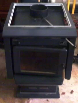

For sale locally is this new Kent stove. Would this be out of Australia or New Zealand? EPA certified? Thanks, Doug

does it have tiles on the sides ? pete
Pete, owner reports no tiles. I read the Kent Tile Fire On hearth wiki - they spoke of the Sherwood model - budget model w/o tiles...maybe this is it?
It's a Tile Fire. The porcelain outer shell is the giveaway, as that's where the tiles were inserted (the Sherwood was just the inner box, no outer shell). To "finish" the Tile Fire, you'd insert six 6x6 ceramic tiles in each side, in two rows of three each. There was a black-finished aluminum keeper with channels at top and bottom that was installed horizontally between the two layers of tile on each side to lock the tops of the bottom tiles and the bottoms of the top tiles in place, and an unfinished keeper that spanned the top of the top row. Wavy thin-gage steel strips went around the outside perimeter of the tiles on each side to provide tension on the tiles to keep them from rattling. Also missing in the photo is the porcelain top plate, which hid the bypass lever and stovetop.
This was maybe the best-performing stove in the US in the 1980's, coming in at around 11 grams/hr while the Fishers, Schraders, Orleys, VCs, etc. that dominated the US marketplace belched out somewhere around 40-60 grams/hr. It burned clean enough to pass the original Oregon standard, but had to be tweaked a bit to meet US EPA Phase I standards, then totally redesigned with a refractory liner and arched refractory baffle system (the Ultima model) to meet Phase II. The listing label on the back of the stove will reveal which incarnation this one is for sure, but it looks like the stage-2 Tile Fire with the "tall" pedestal. If so, it predates the EPA standards, and would not be legal to install in states that require EPA certification.
Which is a shame, because in terms of burn time, heat output, controllability and user-friendliness, that stove is one of the best I've ever burned.

Thanks, guys. I hope to eyeball it tomorrow. Tom, exceptional historical and functional data - TYVM. Would you have a manual I could buy?
Eyeballed stove today. Looked good. Never been fired. Had rust in firebox and on damper. The tile holder brackets are rough but something can be adapted. Manufactured July 86. Owner acquired by buying a public storage unit - it's been sitting there for ?decades?. Had a UL label with clearances, so, not so worried about a manual. We made a barter deal - my trade was worth $175. Quite pleased to get it. Now, for the Iron Bowl - WAR EAGLE!

Thanks, BG. Neat stove - the damper rod has a metal plate that locks door latch when bypass damper closed...you can't forget and get a face full of smoke.
