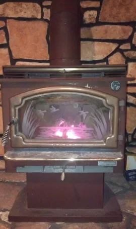

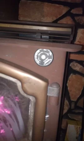

    Hello All,
    i am new to the forum and new to wood stoves (at least burning one as a main heat source. ) and now that i am midway through my first burning season i have some questions...
    I moved into a new house last spring and was more then thrilled to see a wood burning stove sitting in the middle of the family room. it is large and centrally located in the house so my next step was to start collecting wood. i was lucky enough to have a friend that had cleared land 2 summers ago to make horse pasture and the trees were free for the taking. all white oak, no more then 12 inches in diameter. it is all well seasoned and has been split and on the rack since summer (been down for more then 2 years total). now for the problems....
    previous owners ensured me that the chimney and stove had been cleaned completely and it certainly appeared so, everything looked vacuumed out and no ash to be seen. out of precaution i ran a brush up the chimney before the season started and very little creosote came down. I've burned about 2 1/2 cords so far and now the stove seems to be acting different. the draft seems to be reduced, not to the point where smoke comes out the door, but it doesn't "scream" wide open like it did in the beginning.
    my plan is to start cleaning EVERYTHING when the weather finally breaks this week. however, i don't have a clue what model stove i have and am looking for a manual to assist me. it's a Lopi (stamped on the door) but all the identifying marks are missing. i think it's early 90's and has a cat. which is also why I'm concerned because after the stove is hot i always run it through the cat and there is no smoke coming out the chimney, so there shouldn't be any creosote build-up... unless i am mistaken.
    i am also looking for suggestions on how to operate a large (at least i consider it large for the house) stove during milder weather... i know i burn cold more then i should, but unless its less then 20 out the stove is just too much. i'm trying to keep it my main heat source with the price of oil, but i don't want to burn dirty and don't want to sweat myself out of the house.
    thanks for the help.
    IMAG0449.jpg IMAG0448.jpg View attachment 90917 View attachment 90916

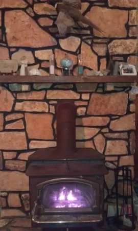

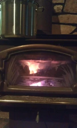

  8. FishKiller New Member
    joined: Jan 25, 2013
    16 posts
    here is a picture 15 minutes after a 4 split reload, running through the cat at about 25% air
    ... seem ok?

    I'm not sure but this looks like it might be a Lopi Flex stove. There should be a label on the back of the stove identifying it. Does it have a big rectangular catalyst? If so, here is the manual:
    http://www.lopistoves.com/TravisDocs/93508019.pdf
