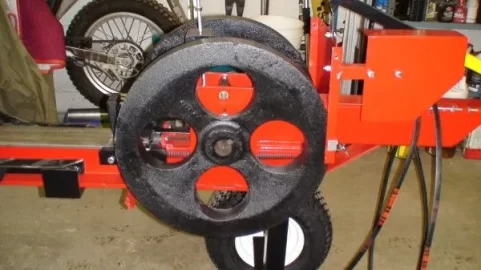

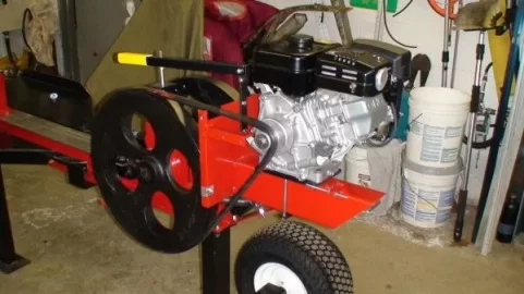

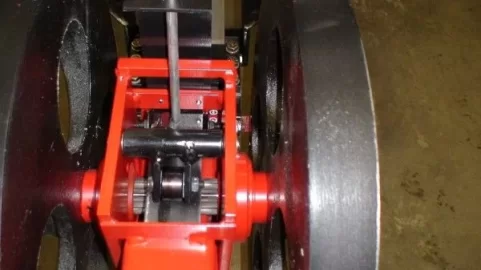

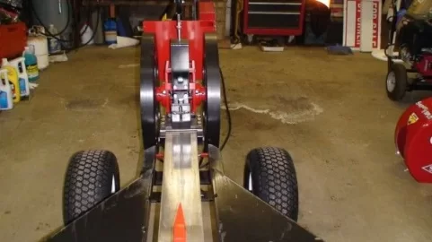

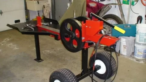

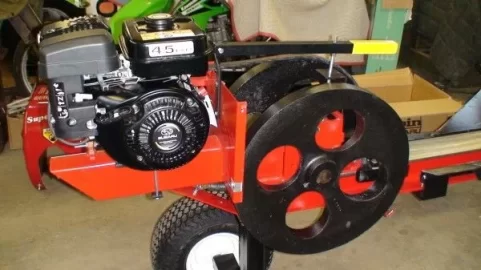

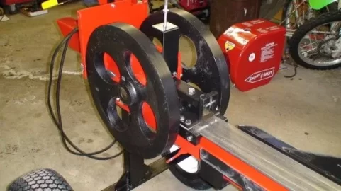

I recently purchase a new model J Super Split with the production table . Had to slide it off a tractor trailer with only a little help from the Fedex guy , heaver than I thought . Having used a high quality hydraulic splitter mostly in the vertical position for 25 years , I found the Super split a real pleasure to operate and I found production is so fast that my pile of splits grew so large I had to stop splitting and spend days stacking . Working sanding up at perfect height fo me is a major treat , the production table is a must . The machine is well worth the money . For the monster logs I will fire up the old hydraulic splitter and reduce them down to manageable sizes vertically .
