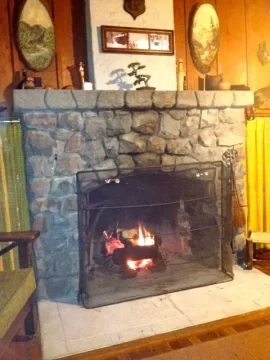

    FWIW - We'd narrowed our choices to something about 28"x3 with a 1.5- 2 CF firebox, with firescreen for occasional s'mores and cooktop/winter grill capabilities for power outages. Our pictured fireplace specs are
    43wide front
    27"wide back
    arch 30-33-30
    depth = 27" bottom o box
    16" @ top of box
    hearth 22.5" deep
    25'+ brick chimney
